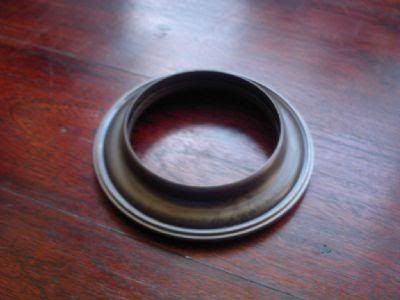

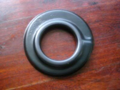

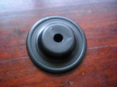

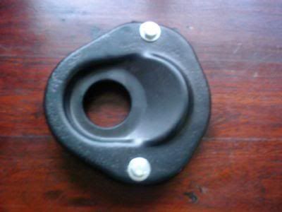

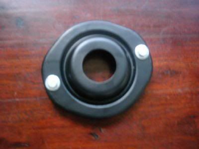

hoeveel moet je der hebben ?" Niet meer te krijgen" is een relatief begrip.
[img]http://i224.photobucket.com/albums/dd11 ... ph2gtt.jpg[/img]
[img]http://i224.photobucket.com/albums/dd11 ... ph1gtt.jpg[/img]
[img]http://i224.photobucket.com/albums/dd11 ... 300ekm.jpg[/img]
[img]http://i224.photobucket.com/albums/dd11 ... x80ekm.jpg[/img]
