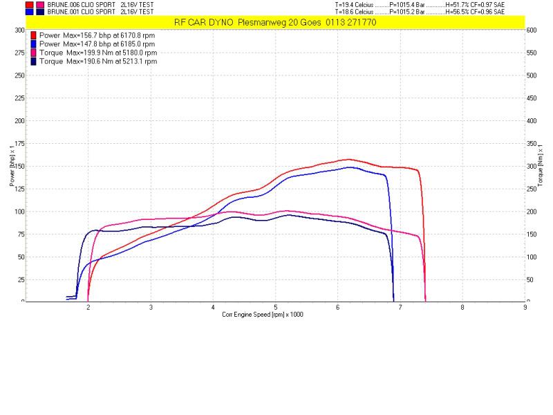

[img]http://img846.imageshack.us/img846/8518 ... ers225.jpg[/img]
